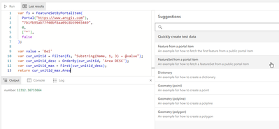

The testing I've done in the Playground using the example public portal item has worked correctly.
