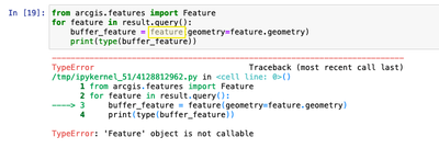

TypeError                                 Traceback (most recent call last)
/tmp/ipykernel_338/3308212656.py in <cell line: 0>()
      1 for feature in result.query():
      2     buffer_geometry = feature.geometry
----> 3     buffer_feature = feature(geometry=buffer_geometry)
      4     new_features.append(buffer_feature)
      5
TypeError: 'Feature' object is not callable
As you can probably tell, I don't have alot of experience in coding. any help would be greatly appreciated

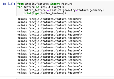

MarkTorrey
From the error message, it looks like you just need to add an uppercase F to feature(geometry=buffer_geometry)? Other than that it looks good and should run...
tendtreesTC
