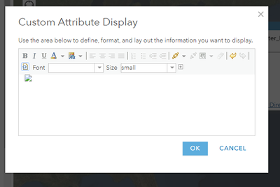

Then I went into the pop-up configuration and chose "A custom attribute display" and inserted the HTML code that was mentioned:
But all I see in the output when I switch from HTML view to regular view in the Custom Attribute Display window is this image icon:

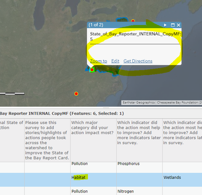

And when I save and close the pop-up configuration the pop-up is empty when I select a feature, even though I have data in the attribute table that says the category:
Any thoughts on what I might be missing?
