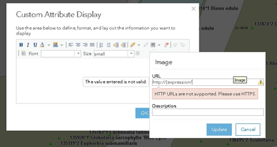

I know the thread is a bit stale - is it possible upgrades have killed the ability to use Arcade with a popup image?
When I attempt to type in the {expression/expr0}, the instant the "/" is typed, an http:// is forced, along with a message that it must be https:  In the example below - I typed "{expression/" - the rest magically appears.
It doesn't seem to be possible to follow your example.
