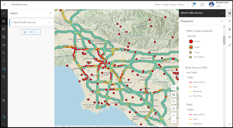

DerekLaw
Esri Esteemed Contributor
Hi @AJThomas1212  and @Bud,
The Live Traffic service is working for me in the New AGOL Map Viewer fine.
I'm unsure what issue(s) you're encountering.
