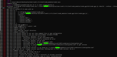

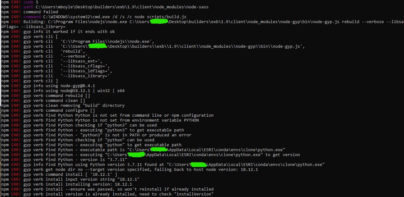

Below are the errors being through when running "npm ci" within the client folder.

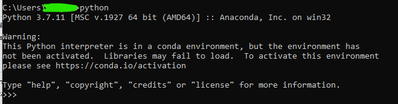

Python is set as a system environment variable. However, because I'm using a machine that has Pro installed, when I run python from the cmd, I get a conda warning about the environment not being activated. I'm not sure if that's the issue or not.

You can force the python path by running this command;
npm ci --python="C:\Program Files\ArcGIS\Portal\framework\runtime\python\python.exe"
This gets me past that error
