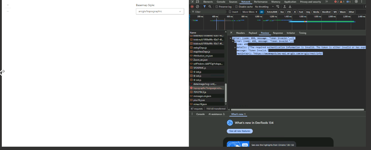

HI,
I am currently using ArcGIS Enterprise 11.4 (Portal-Federated Server) with a developer account subscription. When generating a simple basic API key, I repeatedly encounter a white screen. Checking the network reveals error 498. I have attempted this in different environments, yet the issue persists. Although my environment is secured, I am facing this problem on my local machine (Secured Environment) where the portal is installed. Each time, the key appears as an invalid token.
"error": {
"code": 498,
"message": "Token Invalid.",
"details": [
"The required authentication information is invalid. The token is either invalid or has expired."

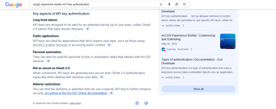

@John Google search might be confusing people on this matter, I tried a search:
arcgis experience builder API Key authentication and it's AI spit out this:
one of the links went here: https://developers.arcgis.com/documentation/security-and-authentication/types-of-authentication/#:~:.... But it does not mention EXB just AGOL and AGE, and a bunch of program language APIs.  There is nothing in that documentation to alert folks that Experience Builder does not currently have this capability, but multiple other products do, unfortunately, that doesn't help those who need that feature
@DeanWilson Unfortunately, I believe John-Foster is correct that EXB does not currently support API Keys.  It can be suggested at: https://community.esri.com/t5/arcgis-experience-builder-ideas/idb-p/arcgis-experience-builder-ideas
