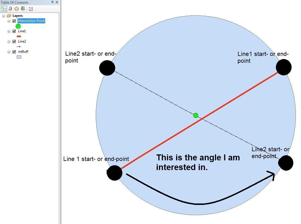

I am trying to determine the angle between two intersecting lines. However, I need the angle to be from the start point of line1 to the start- or end-point of line2 - whichever is the next point going in a counter-clockwise direction around the circle's perimeter (see diagram at bottom of question).

a few points on the image or directional arrows to we know where start and end points are

I have added points on the image to show where the start- or end-points are. The start- and end-points correspond with where the line feature touches the boundary of the polygon circle. However, in the data, the start- and end-points do not follow a particular pattern or direction.
For my purposes, it doesn't matter if I am comparing a start-point of line1 to an end-point of line2. All that matters is that the point of line1 is being compared to the point of line2 that is first encountered going counter-clockwise around the circle's perimeter.
In the Picture in my edited post I would want to compare the two points with the arrow drawn between them.
