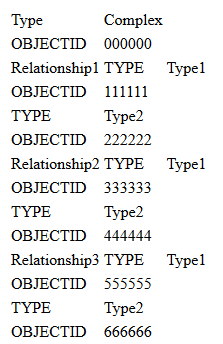

You could construct in a single Arcade expression a HTML table and return it, but it will be seen as plain text by the pop-up and show as such. See the expression below:
var txt = '[{"Type": "Complex", "OBJECTID": "000000","Relationship1": [{"TYPE": "Type1","OBJECTID": "111111"},{"TYPE": "Type2","OBJECTID": "222222"}],"Relationship2": [{"TYPE": "Type1","OBJECTID": "333333"},{"TYPE": "Type2","OBJECTID": "444444"}],"Relationship3": [{"TYPE": "Type1","OBJECTID": "555555"},{"TYPE": "Type2","OBJECTID": "666666"}]}]';
txt = Replace(txt, ' ', '');
txt = Replace(txt, '[', '');
txt = Replace(txt, '{', '');
txt = Replace(txt, ']', '');
txt = Replace(txt, '}', '');
txt = Replace(txt, '"', '');
var test1 = Split(txt, ',');
var test2 = "<table>";
for (var i in test1) {
    var row = test1[i];
    var lst_row = Split(row, ":");
    test2 += "<tr>"
    Console(row);
    for (var j in lst_row) {
        test2 += "<td>" + lst_row[j] + "</td>"
    test2 += "</tr>"
test2 += "</table>"
return test2;
Which will produce something like this:
and not something like this (which still does not represent something very readable):
To achieve what you are after, you would probably construct the html in the pop-up and fill each field with an expression that would extract the relevant value from the data you have. Not a very elegant solution...
