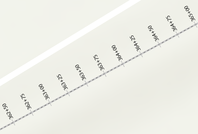

I was able to connect to the data and I see what you mean. The field reference I proposed has a fixed reference to the length of the line. There is a special reference that points to the measurement: $measure.
Your code would look like this:
var segLen = Round($measure * 3.2808399, 0);
return Round((segLen - (segLen % 100)) / 100, 0) + Text(segLen % 100, "+00");
Resulting in:
XanderBakker
Esri Esteemed Contributor
Maybe a small suggestion and change the interval to: 7.6199999884176 (25 feet in meters):
