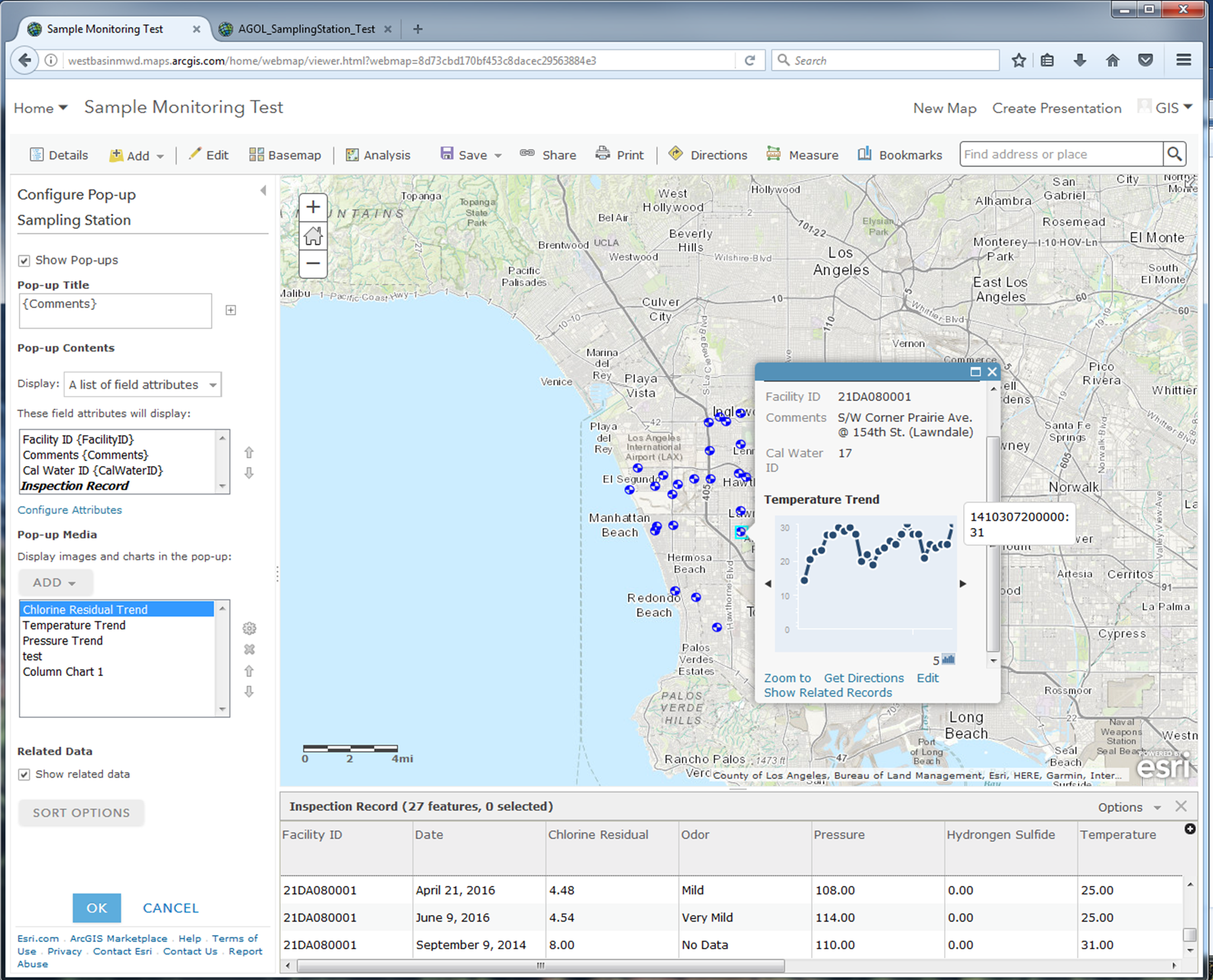

I have a point feature class with related table saved in AGOL that has historic surveyed values with a date field.
I've been configuring the pop-up to show the numeric values in related table as a line chart media, and faced with two issues.
Screenshot of Related Table and chart design
  1.  Date Field cannot be configured to ascending/descending order when designing the chart.
    Is there a way to configure the related table's date field to show the chart in temporal manner?
    As you can see in records, the dates are not in order and the chart can be misleading
  2. Date Field displays as 13-digit numeric values when the mouse hovers
    When a mouse hovers on a chart, the value "September 9, 2014" displays as "1410307200000"
Any suggestions or guidance would be grateful.

I have the same exact issue. Many of my dataset are time series. This type of one (feature) to many (records) data is norm in scientific communities; however, both chart and related chart widget do not seem to support it. Both axis are not configurable and x-axis label is not even displayable.

I took the issues to the User Conference, and I spoke with AGOL engineers and other staffs.
Esri technician acknowledged the problem of non-chronological order and the incorrect time label, and issued the tickets.
We might have to wait little longer to get those enhancements though.

A work around would be to create the graph with a different application and then add it as an image to the pop-up (same place as you add the chart).  Not great, but I'm considering it.
