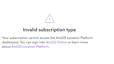

I added a new OAuth Application to my developer portal last night and when I woke up this morning I was not able to view or edit it's redirect URL's. The Developer Portal seemed to have been moved to the new ArcGIS Location Platform. However, I am not able to login to this platform to edit the creds I was able to edit last night. When I attempt to sign in this is the error I get.
How can I get access to this platform so I can continue my web application integration? Do I need to maintain 2 accounts? If so how do I access my organization's private web views?

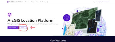

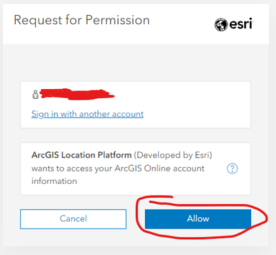

Here is how I am navigating to the ArcGIS Location Platform
MiguelCaballero_1-1719498806158.pngMiguelCaballero_2-1719498844180.pngMiguelCaballero_3-1719498915941.png

Hi @MiguelCaballero the tools in the old developer portal were always just a sub-set of what existed in your portal on ArcGIS.com. So you can manage your redirect URLs by navigating to the item inside "My content" and going to its item details page.
You can refer to these doc pages:
https://doc.arcgis.com/en/arcgis-online/manage-data/add-app-url.htm#REG_APP
https://developers.arcgis.com/documentation/security-and-authentication/user-authentication/tutorial...
The presence of ArcGIS Location Platform in the app switcher is a bug and should be resolved soon. You should not be able to access ArcGIS Location Platform since you already have ArcGIS Online.
