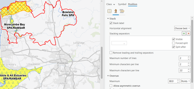

MadhuriShetye
Hi,
I wanted to add some labels on a new line, so I searched and found a solution here. However, I faced the same issue where it didn't work initially, Then I explored the label properties and I got the answer, In label properties >Fitting strategy> stack label by removing the space option I finally got it to work
