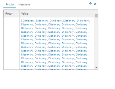

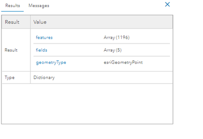

But this outputs all the values as individual dictionarties and I would prefer to have this as one new table / dynamic feature set to use in a pie chart.
Any Ideas where I've gone wrong? The Feature(Text(OutputDict)); just returns a blank table.
Thanks 🙂

You're assigning the dictionary a geometry type, but not using that at all. Try using this
var OutputDict = {
  fields: [
    { name: "organisation", type: "esriFieldTypeString" },
    { name: "PostcodeSectorAv", type: "esriFieldTypeInteger" },
    { name: "PostcodeSectorCount", type: "esriFieldTypeInteger" },
    { name: "GSS_CODE", type: "esriFieldTypeString" }
  geometryType: "",
  features: []

Thanks - this still produces multiple dictionaries whereas I want these results in a feature set to run my pie chart off on dashboards. any ideas on this? Thanks
