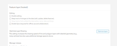

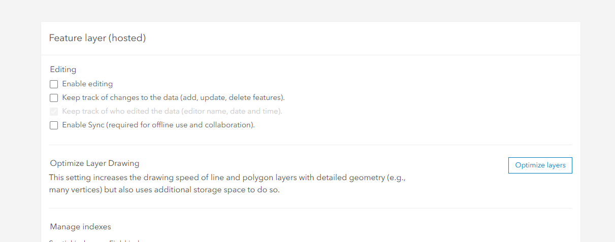

Hey Pipelines Team,
I haven't been able to find this in the documentation so I thought I'd ask it here.  Does editing need to be enabled in the service for Data Pipelines to work/write to the layer? I've had mine off and it seemed to still work, but wanted offical documentation on this.
