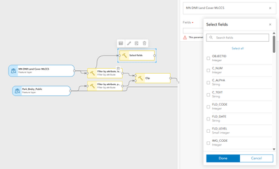

Amanda__Huber
MVP Regular Contributor
HI @MaxPayson
Thanks so much for your response! Good idea, I tested your workflow with the "Select Fields" tool and I was successfully able to view the fields with no server error (which is promising):

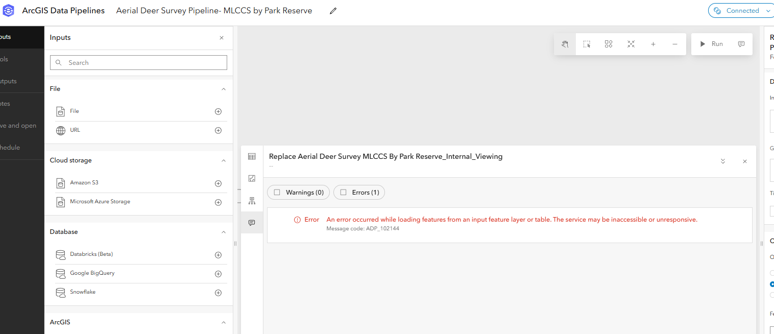

That being said, when trying to preview the output in the pipeline, this server error popped up, it appears our "The ArcSOC process for this service may not have enough memory allocated to it." so that was great insight you provided. We've updated the javaHeapSize and it appears to be working correctly in Pipelines now 🎉
