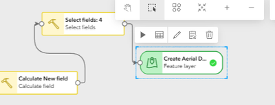

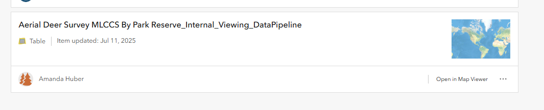

We recently noticed when we add the tool "Select Fields" our Feature Layer output turns into an AGOL Hosted table instead:

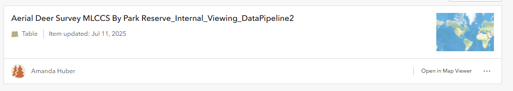

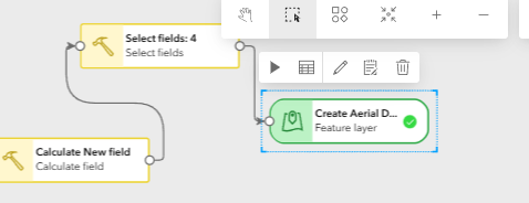

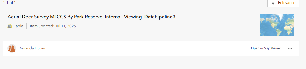

I tested this a few times and it resulted in the same output:

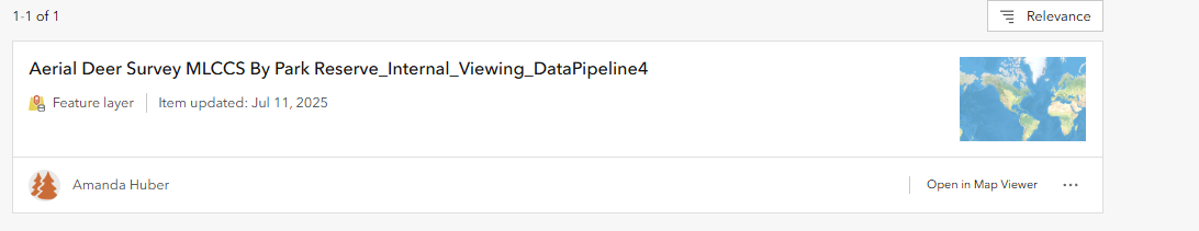

When removing the tool and testing the output, the output is a Feature Layer as expected:
Please let me know if I'm missing something.
