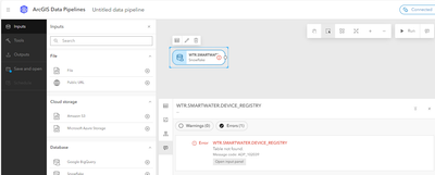

I am able to establish the connection to snowflake but cannot view any tables that I can access via the browser.  Any ideas as to why?
