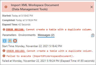

I also tried it with ArcGIS Pro version 2.8.2. I first exported the new XML document and then imported it in an empty File GDB, but I am getting the same error.
However, this time the error was a bit specific, here at this link.
