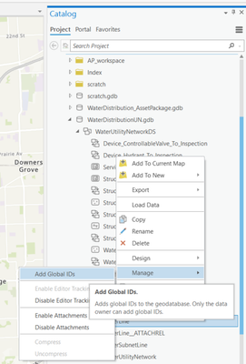

Hi @SarahHartholt ,
Just go to your featureclass in the catalog window, right click, choose Manage and you will see the option Add GlobalID's
SarahHartholt
Thank you!
