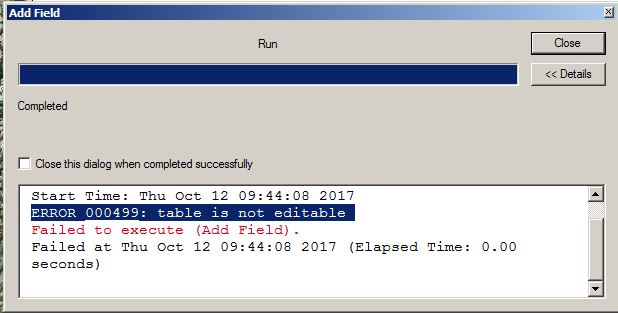

I am adding a field to a feature layer in a geodatabase using AddField in Model builder but I am returned wit the error message "
ERROR 000499: table is not editable.
When I try to manually edit the same layer using start editing it is editable. I checked for Locks on the geodatabase and there are no lock files on that work space. I wonder if any body can help resolving this problem
Hossam
HossameldinElalkamy
I figured out whats the problem. It was that this layer is joined to another table. Removing the join solves the problem and addField in the model works fine. Thank you all.
