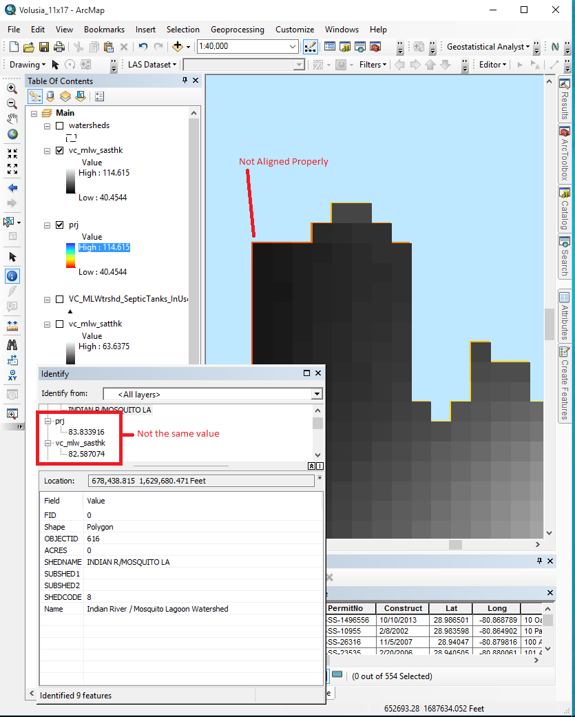

I'm working on a project and I need to reproject some rasters from NAD83 UTM to NAD83 SP. Easy enough. When I take a look at my original raster and my re-projected raster, I notice that they are not quite the same, however. As you can see in the screenshot. My original raster is on top (vc_mlw_sasthk in the table of conents) in black and white, my projected raster is on bottom (prj in table of contents) in a brighter color ramp and you can see it is not quite aligned with the original raster. You can also see that in some areas, the cell values have changed slightly (enough to make me worried).

Reprojection tends to introduce a bit of data massaging as the pixels which do not have any data will have to be given some value somehow during the resampling/rotation/ reprojection. If you need to maintain the actual values of the pixels you would need to convert the raster to points, reproject the points, then convert it back to raster of the exact same pixel size.

HannesZiegler4
Deactivated User
