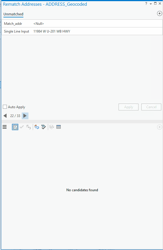

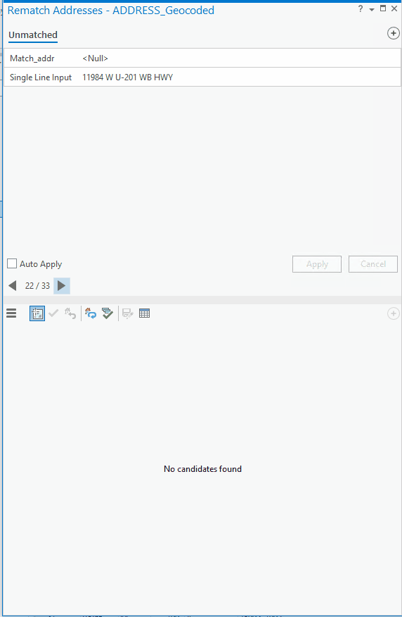

In this post from  June 2020 I showed a problem with rematching an address.  I'm using ArcGIS Pro 2.6 now and the problem persists.
Here is my work flow:
I have a selected set of unmatched addresses that I am stepping through interactively.  I make a change to an address, <tab> and click apply. And I'm pushed back to the beginning of the selected unmatched records where I then manually advance (again) to the address I just changed so I and check it and I go back to the beginning of the selected list.
This is more than an irritation, it's really counter-productive.  If you have anything more than a few records selected it's really a pain in the backside.
In the last post @ShanaBritt , you mentioned you couldn't replicate the problem.  Here's a gif of me replicating it today, 1/27/2021...
