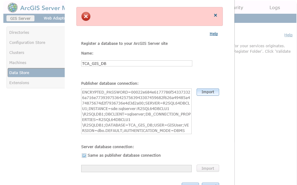

I am tryingto register a versioned geodatabase using ArcGIS Server Manager and I am facing the problem shown in the image herewith attached:
I am receiving this message on which I have no clue !
Am I missing something here?

Was there an error message given in the red bubble? It will be very difficult to troubleshoot with no error message.
Have you tried to re-install the SQL Server Native client on the ArcGIS Server machine, I would make sure to use the 64-bit 2012 native client?
Also make sure that the ArcGIS Server machine has access to the SQL Server database instance.

Also, try registering the database with ArcGIS Server from ArcCatalog and check if you observe the same issue there.

Any specific error in AGS logs? Logs may provide some help in debugging the problem.
