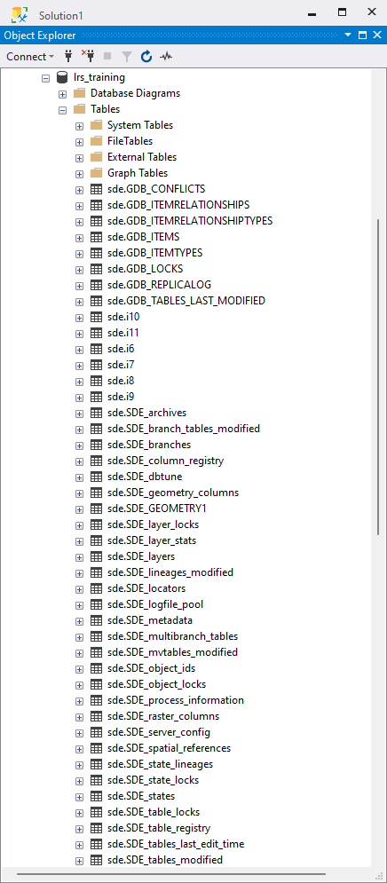

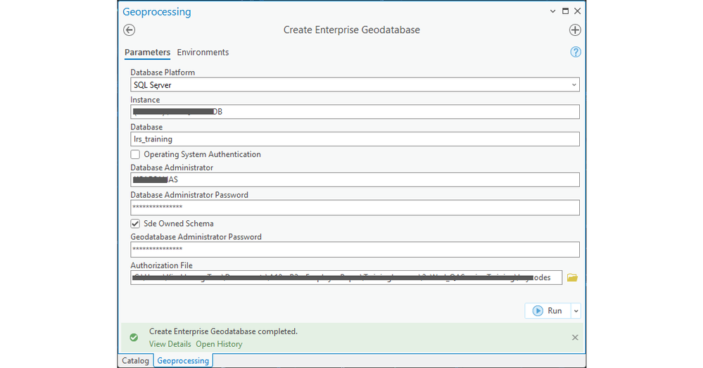

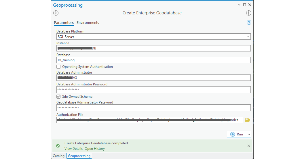

I've got the above error when trying to follow the instruction of lesson "Migrate an LRS to an enterprise geodatabase" The lesson first shows how to create an enterprise-geodatabase and then how to make a connection to the created db. I chose platform MSSQL, was able to create one and can make a connection to it via New Database Connection tool
The created MSSQL database is per field entries as follows: (resulted in a sde schema indeed)

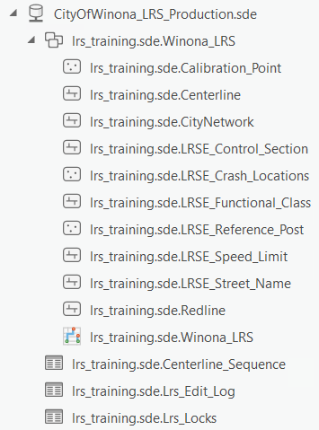

PS 1: I obviously want to achieve somthing like this

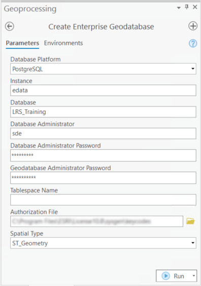

Unfortunately the lesson example only showcased PostgreSQL based geodatabase creation:
Therefore, I do not have matching instructions or references to look up against.

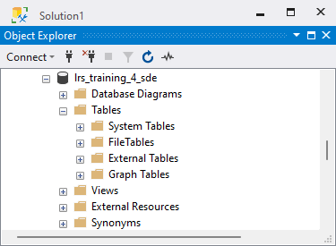

PS 2: I also tried to create a db-admin account where the username is "sde" so that it is identified (the same) with the schema name sde but that same Paste Error fires up again when I tried to paste the source LRS feature dataset into destination newly created "irs_training_4_sde" MSSQL database - as shown below. In this trial, the outcome was even worse, there were not any sde. schema based tables generated when it finished running the Create Enterprise Geodatabase, all I got is this:
