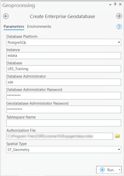

PS 1: I obviously want to achieve somthing like this
Unfortunately the lesson example only showcased PostgreSQL based geodatabase creation:
Therefore, I do not have matching instructions or references to look up against.
