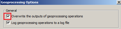

Go to Geoprocessing > Geoprocessing Options.
The "Overwrite the outputs..." option should be checked.

It is checked already
