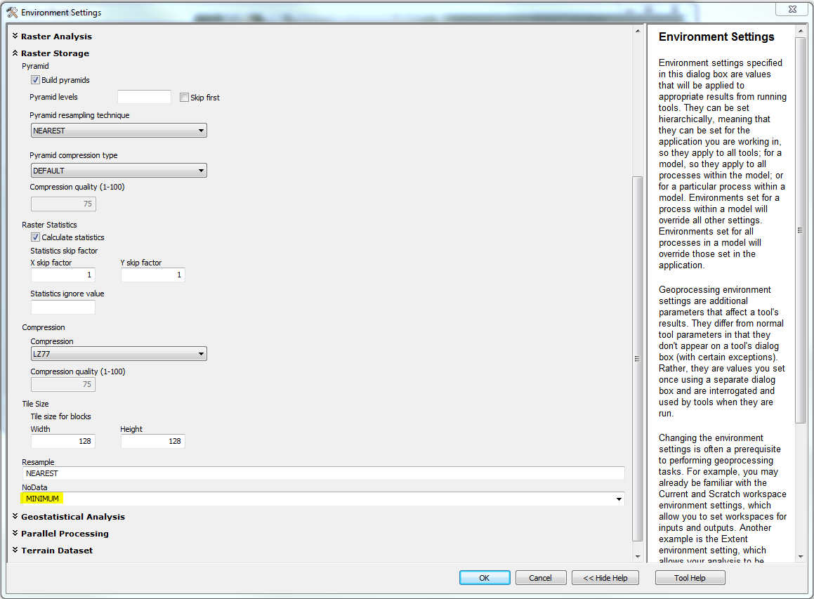

If you require TIFFs, I would recommend running the Project Raster tool.  In order to get rid of the blank edges, you can set the NoData value within the Environments.  I'm assuming the values 0,0,0 are being converted to the black edges.  If this is the case, you can set the NoData value to 'MINIMUM'.  This will convert the 0,0,0 values to NoData.  Ex:

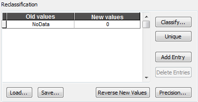

JayantaPoddar
MVP Alum
Hi Ben,
If the black edges are "NoData" values, you could use Reclassify tool. Select all the records except "NoData" and click Delete Entries
Define the new values to 0.
