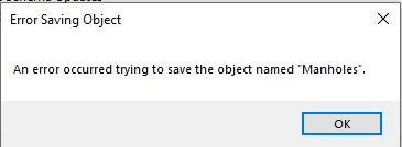

I attempted to export the feature class using ArcMap instead of AGOL (as shown here), hoping that would force the FGDB to my current version. However, this continually fails with any name in any location. This may be related (or not).
JoeBryant1
I was able to get around the Export Data wizard error by using "Feature Class to Feature Class" GP tool. Still no option to select the GDB version, but I shouldn't be able to save in a higher version from 10.7.1.
