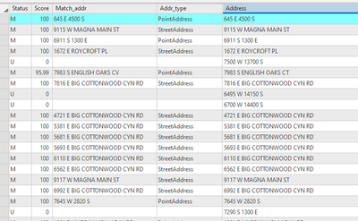

I have created a multi role locator with a point address role and a street address role.  I have an address of 645 E 4500 S (one of 116,000 in my address data table)  When I match the table to the  multi role it does not match.
However, when I look at the address point data, there are two records that have 645 E 4500 S parsed out in the various components field: one has a sub unit (another parsed field) and the other does not.
The street data has a segment that covers the range.
When I match against a single role point address locator, that address fails. When I match against a single role street address locator it matches.
What is going on here?  I thought that a multi-role locator acts like the old composite address locator does: if an address doesn't match on one it matches on another if it can.  Why would this particular address match only against a single street address locator and not in the multi-role locator when it should validate in either?

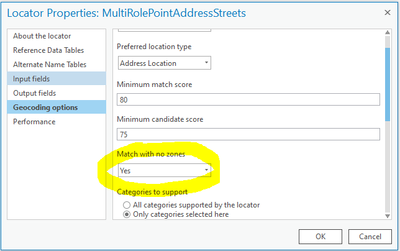

Thanks to a suggestion from @BradNiemand I was able to get past this issue.  I made sure my multi role locator property of Match with No Zones = Yes and that seems to have done it .
That particular property can only be set manually after a locator is created.
