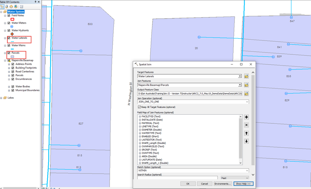

Hi @DonRodgers, Do your Sewer Laterals intersect with your parcels? If so you have the option of a Spatial Join where you can use one of the several match options (Best match method is probably 'Within', but 'Have their center in' might also be good if your lateral midpoints are inside the parcel).
Spatial Join for Water Laterals and Parcels. Output will contain attributes from both feature classesSpatial Join for Water Laterals and Parcels. Output will contain attributes from both feature classes
In the field map of Join Features you can specify which attributes to put into the output feature class, in this case you might select for only the Address attributes from the Parcels features.

BenCoubrough
