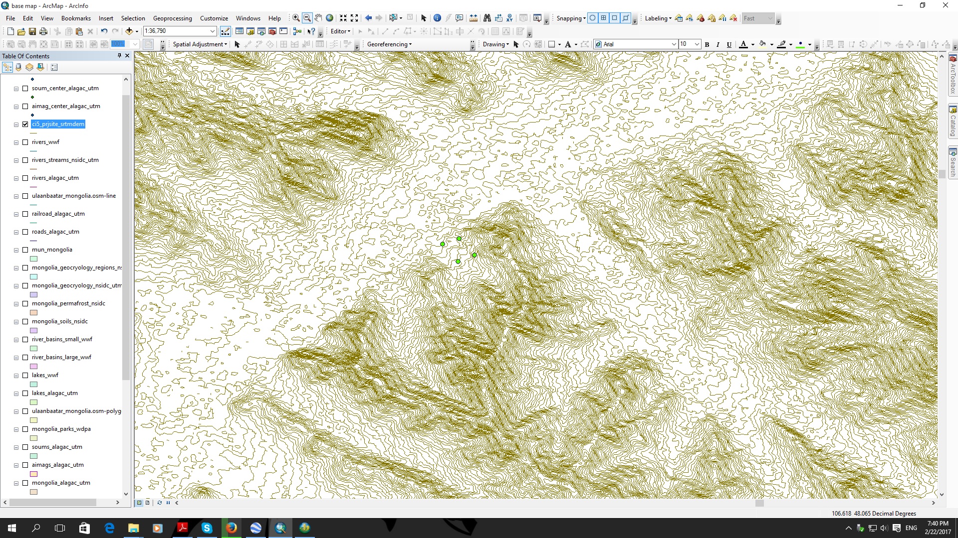

How can I generate nicer contour map from SRTM DEM data downloaded from the internet.
I already did the process using 3d Analyst and here's my output.
I made used of these data attached.
Please advise if there's any other way to generate contour. This is 5 meter contour interval.

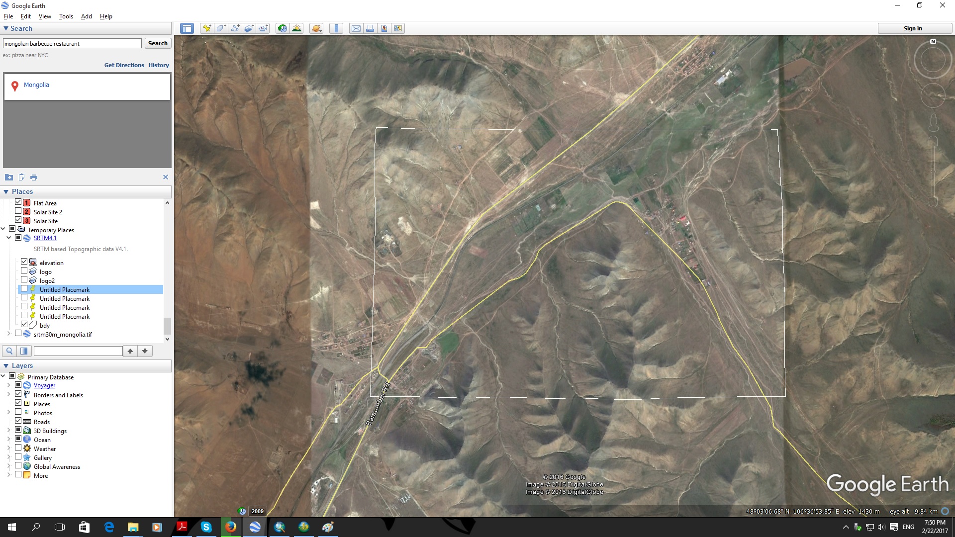

This is the Sat Image from Google Earth.

I tried using your data and creating contours directly from the SRTM DEM did generate alot of erroneous looking contours.  I believe this can be attributed to mainly the fact that your elevation values are all integers, with no floating point.  Therefore, it can create contours around the edge of several cells since they can easily have the same elevation.  In order to make more cartographically pleasing contours, I ran the Focal Statistics Tool using a 3x3 window calculating a mean value for each cell.  This obviously degrades the data from the original slightly, but does also create contours that are mcuh closer to the type of contours you are expecting.  It also has the benefit of generating floating point elevation values(since we are averaging many integers), instead of the integer values that caused alot of our artifacts.
In the below screenshot, the purple lines are the contours generated by the unsmoothed DEM, the light blue are the contours from the smoothed DEM.
I hope this is what you were looking for, let me know if you have any further questions.

i just followed your suggestion by using the focal stat tool and here's my output.
Way much better than my previous output.
I didn't change the default figures for processing the raster and after that i just click the contour under 3d analyst.
If i make the lines smooth, do the accuracy of contour would change? i mean is it necessary to smooth the line if the objective of this contour data will be for construction purposes.
