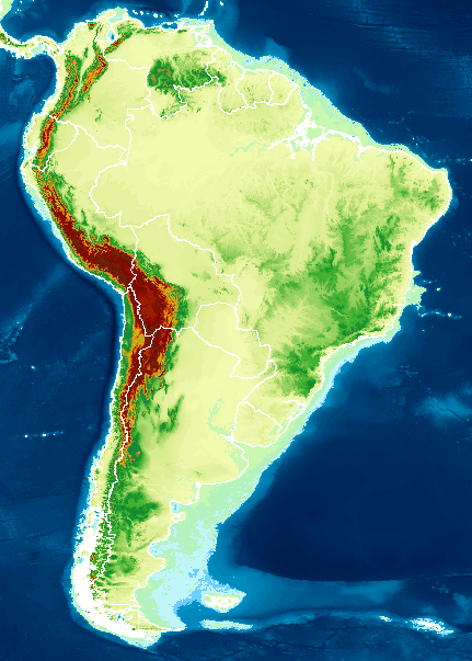

I am trying to use the stretched color option with a topography raster. I have a color bar that I painstakingly make in arc and I am basically trying to set values of the topography equal to certain colors using the histogram. The problem (I think) is the histogram doesn't have a break where I need it - it has a -40 then jumps to 19. I want a break at 0 so sea level will align with my shift from blue to green in my color bar. So is there a way to set these values?  Or is there just a better way to do this altogether?
I would use classified color, however it doesn't seem to have a way of ramping the color between the bounds. Its just a single color for a range, and with only a maximum of 32 intervals it doesn't look very good.
Here is a picture of my best result using stretched. You can see the areas on the coast that are green.

Yeah I've been messing with that - that's what I am talking about when I say it jumps from -40 to 19. Here you can see the two points in the middle are at -40 and 19, and there is nothing in between them no matter how slow I move my mouse.
I will say I don't really understand what this histogram is doing, so maybe there is a better way. I don't really understand what the y-axis is on this. What I am wanting to do is stretch the negative values within the blue portion of my color scale, and the positive values within the rest. But again I need the zero to be distinct.

That's a clever solution. But I think I got it good enough by messing with the Image Analysis tool and just slightly changing the gamma value. Here is my (hopefully) end product, at least as far as the color bar is concerned. It isn't perfect, but then again it never is.
