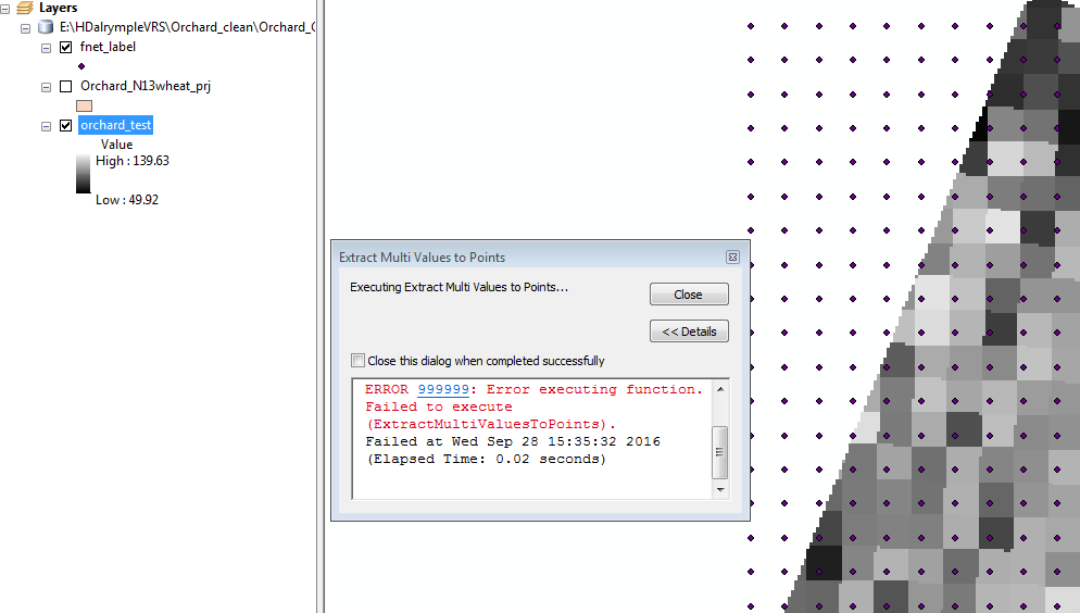

I used 'extract multi values to points' or 'sample' to extract values from several rasters but I kept getting error 999999.
They work fine if I save the rasters under a folder rather than geodatabase.
'Extract values to points' can work even the raster is in geodatabase.
Just to confirm is that a tool bug or something?

I can confirm that the reason for this problem is the fact that the point featureclass "fnet_label" does not have any coordinate system defined. Please always try to have the same projection for the data that will be used in a spatial analysis to avoid problems.
You should use the Define Projection tool to set the correct projection:
After that you can use the Extract Values or Extract Multi Values tools to extract the values from the raster:
... and it will run without problems:
And where the points are located on a pixel value that value will be extracted:

Sorry I am not sure if this is the correct answer.  I do it again today but it turns out the same issue.
'fnet_label' has the same coordinate system as my raster. Here are screen shots:
Extract values to points works fine though ... ...
