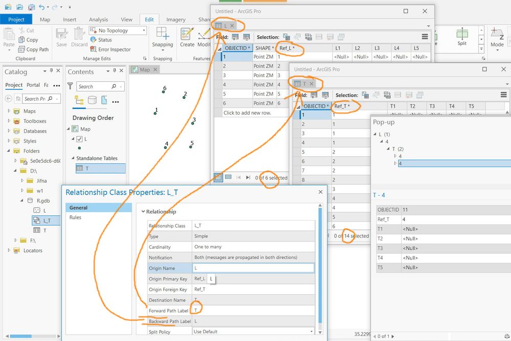

Not sure if experts can help on this. The data is attached
