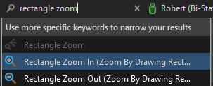

There is a command called "rectangle zoom in" (and "out") that can be accessed via command search (top right) or added to the QAT/Ribbon.

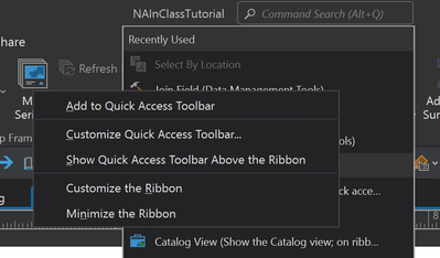

Once you see it in command search, R click > Add to QAT.
To get them on the ribbon, I believe you do that from Pro settings but I'm no expert at that. (From that Customize the Ribbon button, somehow)
