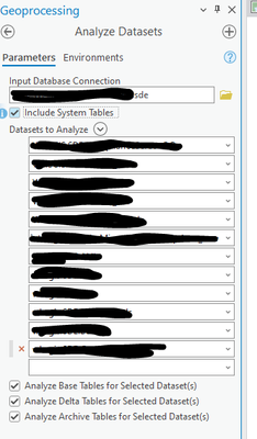

MarceloMarques
@AndreaB_
1) Is there a way to pick all Datasets in the geodatabase? Would be nice if we had a select all button here - I have a lot and I haven't picked them all from the drop down yet. I think you all are going to say - use Python. and I'm sure I should but I really just wanted a quick way to run this tool on all datasets.
[Marcelo]: You can drag and drop all the featuredatasets, featureclasses, tables into the "Datasets to Analyze" box and the tool will update the statistics for all of them. You can them turn the tool into a Model Builder or Python Script.

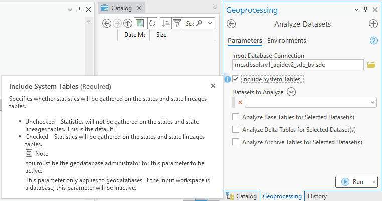

2) I see Only datasets that are owned by the connected user will be displayed.  So do people end up running this tool at least twice - once as 'sde' and once as the DataOwner user?
[Marcelo]: I prefer to always use the data owner user connection to analyze and get new statistics, I do not use the sde user connection. If I have multiple data owner users, then I execute the analyze multiple times.
Note, you still need to run the Analyze with the sde user connection but with the option "Include System Tables" to update statistics of the ArcSDE Geodatabase tables. When you run the Analyze with the data owner users you turn off that option.

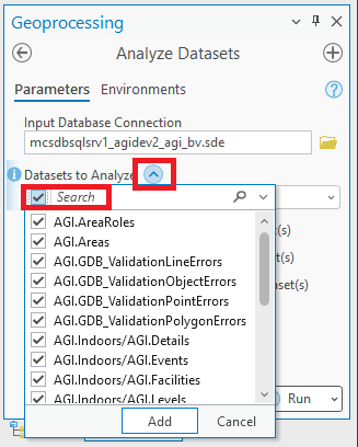

MarlonAmaya
Hi @AndreaB_ ,
With tool you can select the down arrow and then click the checkbox. yes, this will only display data owned by schema owner and should be ran with "data owner" and SDE user.

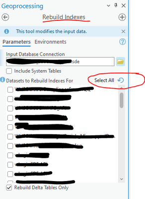

AndreaB_
Now I know why I was looking for the Select All button - because there is one on the Rebuild Indexes pane (see below). Are you aware of any Ideas to make these panes have the same look and feel to 'select all'? or @KoryKramer ? Super confusing to have to 2 different ways (and the help documentation doesn't talk about Select All). If there isn't one then I can start one.
Thank you!

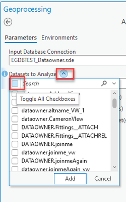

AndreaB_
MarlonAmaya
Hi @AndreaB_ ,
AndreaB_
ah ok!! Thank you both!! Never knew that little arrow was there hiding the checkbox for select all. And the rest all makes sense to me. Appreciate it!
