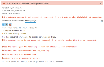

But unfortunately, I still get the same error from the Create Spatial Type GP tool:
The database version is not supported. [Success] Error: Oracle version 18.0.0.0.0 not supported.
See the setup log in the following location for additional error information:
Could not setup Esri spatial type.
Failed to execute (CreateSpatialType).

VaibhavS
What is the error message found in the setup log? That could provide us with more details.
Bud
@VaibhavS Could you explain what you mean by the setup log?
Thanks.

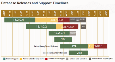

You shall be able to create the Enterprise Geodatabase ArcSDE Repository in your Oracle XE PDB, I never tried myself with Oracle XE because I know the limitations of Oracle XE, even if you manage to create the geodatabase under Oracle XE then the geodatabase might not work as expected, note, you need the st_geometry library only if you plan to run SQL Queries with st_geometry functions, otherwise the geodatabase will continue to work fine without the st_geometry library, an alternative to this is use Oracle SDO to store the data with your Oracle Geodatabase and use SDO functions with SQL, the st_geometry library is compiled for Oracle Standard and Enterprise Editions, thus even if you have the correct version of the st_geometry library that matches your Oracle XE version, the st_geometry library might not work with Oracle XE, I suggest you to install Oracle Standard Edition or Oracle Enterprise Edition, also consider to use Oracle 19c because Oracle 18c (Innovation Release) is deprecated now, and Oracle 21c ( the new Innovation Release) has a very short life spam and short patch cycle, the long term release with a long patch cycle is still 19c.
Release Schedule of Current Database Releases (Doc ID 742060.1)
Oracle Database (RDBMS) Releases Support Status Summary (Doc ID 161818.1)

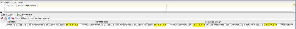

I queried a different production environment that works with ST_GEOMETRY:
  • Oracle 18c
  • 10.7.1 enterprise geodatabase
  • Full ST_Geometry library is available (not just the spatial type)
But I don't really know what I'm looking at in the result of that query. It mostly mentions 18.0.0.0.0. But does mention 18.3.0.0.0 in one spot.
I wonder what we can learn from that. In that environment, is ArcGIS Pro treating the database as 18.0.0.0.0 or as 18.3.0.0.0? If it's treating the database as 18.0.0.0.0, I wonder why my organization was able to create the spatial type in that environment, but I can't do it in my 18.0.0.0.0 XE environment?
VaibhavS
@Bud
In the error message, there's a path that can be used to check the setup log file.
I believe we can obtain additional information regarding the error message from the log file.
