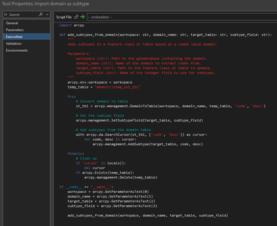

LizAbbey
Thanks for the code, @SSWoodward. As written it doesn't prevent the user from nominating a non-integer domain, or from selecting a subtype field that is not an integer type - both scenarios make the script fail.
I was able to save this as a python script inside a toolbox and added in some validation to only allow selecting an integer field for the target subtype field. I wasn't able to limit the domains to integer domains though (limited python knowledge). My workaround is to prefix subtype domain names with "subtype_" so I know they're formatted correctly.
This is an excellent workaround for me and I have posted the entire script with screenshots below.

Execution:
Screenshot
Code:
import arcpy
def add_subtypes_from_domain(workspace: str, domain_name: str, target_table: str, subtype_field: str):
    Adds subtypes to a feature class or table based on a coded value domain.
    Parameters:
        workspace (str): Path to the geodatabase containing the domain.
        domain_name (str): Name of the domain to extract codes from.
        target_table (str): Path to the feature class or table to update.
        subtype_field (str): Name of the integer field to use for subtypes.
    arcpy.env.workspace = workspace
    temp_table = "memory\\temp_out_tbl"
    try:
        # Convert domain to table
        st_tbl = arcpy.management.DomainToTable(workspace, domain_name, temp_table, 'code', 'desc')
        # Set the subtype field
        arcpy.management.SetSubtypeField(target_table, subtype_field)
        # Add subtypes from the domain table
        with arcpy.da.SearchCursor(st_tbl, ['code', 'desc']) as cursor:
            for code, desc in cursor:
                arcpy.management.AddSubtype(target_table, code, desc)
    finally:
        # Clean up
        if 'cursor' in locals():
            del cursor
        if arcpy.Exists(temp_table):
            arcpy.management.Delete(temp_table)
if __name__ == "__main__":
    workspace = arcpy.GetParameterAsText(0)
    domain_name = arcpy.GetParameterAsText(1)
    target_table = arcpy.GetParameterAsText(2)
    subtype_field = arcpy.GetParameterAsText(3)
    add_subtypes_from_domain(workspace, domain_name, target_table, subtype_field)

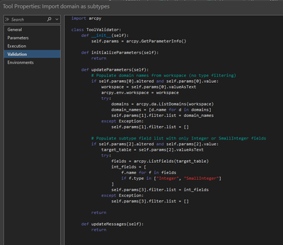

Validation:
Screenshot
Code:
import arcpy
class ToolValidator:
    def __init__(self):
        self.params = arcpy.GetParameterInfo()
    def initializeParameters(self):
        return
    def updateParameters(self):
        # Populate domain names from workspace (no type filtering)
        if self.params[0].altered and self.params[0].value:
            workspace = self.params[0].valueAsText
            try:
                domains = arcpy.da.ListDomains(workspace)
                domain_names = [d.name for d in domains]
                self.params[1].filter.list = domain_names
            except Exception:
                self.params[1].filter.list = []
        # Populate subtype field list with only Integer or SmallInteger fields
        if self.params[2].altered and self.params[2].value:
            target_table = self.params[2].valueAsText
            try:
                fields = arcpy.ListFields(target_table)
                int_fields = [
                    f.name for f in fields
                    if f.type in ["Integer", "SmallInteger"]
                self.params[3].filter.list = int_fields
            except Exception:
                self.params[3].filter.list = []
        return
    def updateMessages(self):
        return
SSWoodward
@LizAbbey Great improvements!
Adding that validation really takes this to the next level. I'm glad you were able to turn my simple example into a full fledged GP tool.  We love to see it.
