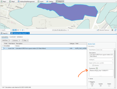

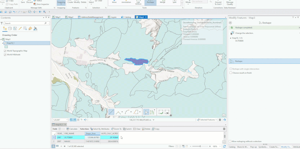

As Richard Fairhurst pointed out in 2016, this has been possible with Attribute Assistant for a long time.
The new technology to accomplish this is Attribute Rules.  https://pro.arcgis.com/en/pro-app/latest/help/data/geodatabases/overview/an-overview-of-attribute-ru...
Set up an attribute rule with a conversion calculation from the feature class' unit into acres:
Here is a related blog: https://www.esri.com/arcgis-blog/products/arcgis-pro/data-management/get-to-the-point-automatically-...
