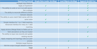

The concepts of appending vs data loading in ArcGIS Pro and ArcMap are similar, but the workflows differ between the two applications. The development team believes the Append tool serves as a replacement for ArcMap’s Object Loader and Simple Data Loader, and also includes a number of enhancements over those ArcMap capabilities.
In ArcMap you can load data into existing feature classes and tables using the Object Loader, or you can use the Simple Data Loader from the Catalog window. Both functions only support loading records from one dataset into another, with simple 1-to-1 field matching between datasets to reconcile schema differences such as fields with different names. The Load Objects function which runs inside an edit session can apply snapping and topology rules as features are loaded.
In ArcGIS Pro you can access the Append tool from the Geoprocessing pane. Or in Catalog pane you can right-click a feature class in a geodatabase and select Load Data to open Append with that dataset pre-populated as the target dataset. Some of the comments in this Idea refer to the location of the Data Loader being customizable, we also want to say that all geoprocessing tools can be added to custom ribbon tab locations as well as the Quick Access Toolbar using these steps:  https://pro.arcgis.com/en/pro-app/latest/help/analysis/geoprocessing/basics/customize-arcgis-pro-wit...
ArcGIS Pro’s Append tool is designed to load the records of one or many input datasets into one target dataset. The Append tool also supports field matching, even if the schema does not match by setting the Field Matching Type parameter to “Use the field map to reconcile field differences.” Just like in ArcMap, any of the fields that have the same name are automatically matched. As the field map supports a number of advanced actions and 1-to-many field matching between multiple datasets, it is not as basic as the 1-to-1 field matching control used in ArcMap. In ArcGIS Pro 3.2, we updated the field map to make it easier to use, you can learn more about these updates, and walk-through an example using the Append tool here. In addition to loading new records, starting in ArcGIS Pro 3.1, Append supports upsert, so if there are existing records in the target dataset that should be updated with new attributes or geometry, that can be done in the same operation.
Below, is a table outlining the differences and similarities between the ArcMap/ArcCatalog and ArcGIS Pro capabilities. Let us know if you see features from either of the ArcMap tools that you think should be integrated in the Append tool in Pro.
