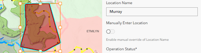

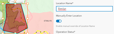

Looks like it works a treat! Used it to enable manual override of a calculated location name based on intersecting features.
Calculated:
Entered Manually:
ShareUser
Esri Community Manager
Calculated:
Entered Manually:

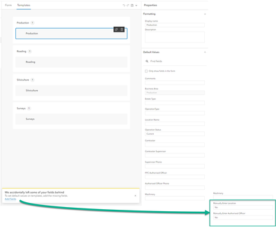

To anyone implementing this, don't forget to also update your feature templates in Field Maps Designer to include the new fields and their default values - this caught me out as I did it in the WebMap smart form editor (which isn't at parity yet with Field Maps Designer).

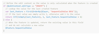

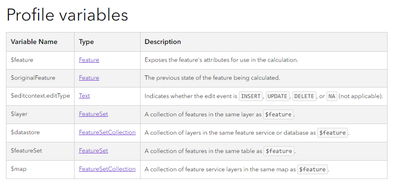

@JCooley_ClackamasSWCD

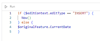

Regarding your question: "I don't want to automatically overwrite the date field when I'm editing another field.  Is there any workaround that allows conditional statements to be used in the calculation code?"
Yes, you can use the $editcontext.editType Profile Variable to determine if the value is calculated only on create or update. Form Calculation | ArcGIS Arcade | ArcGIS Developers
Some application examples in here: Go Beyond the Smart Editor using Smart Forms (esri.com)

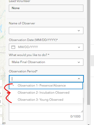

Cross posting this question here too, with hopes someone has a creative idea for a workaround until Esri resolves this.
Unfortunately the workaround doesn't quite work with our workflow, there's no use case for a toggle override.
Our workflow- We have three types of observations. These observations are typically sequential in order based on the bird's nesting time-frame and all fields are editable
-but-
Sometimes volunteers don't get to a nest until observation 2 or 3 in which we need the prior observations's fields to to be calculated to our default (use the calculated expression).
I don't see a good way to fit a toggle into this scenario with our workflow. Please let me know if you have any ideas.
That being said, I think there are many use cases for this to be an enhancement that Esri implements as it's quite silly that calculations and editability can't both be in a form
Thanks,
Amanda Huber
https://community.esri.com/t5/arcgis-online-questions/arcgis-online-map-viewer-forms-logic-issue/m-p...

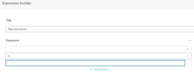

In the Editable expression, I set the field to be editable when the field is not empty.  So, the calculated expression runs and is editable, but if the field is empty it is no longer editable (which shouldn't happen if the calculated expression works correctly).  Maybe this code example will show it better than I can explain it.
if($feature.LastInspectionDate == null || IsEmpty($feature.LastInspectionDate)) {
  return false
} else {
  return true
It works well for new features, but when you're editing a feature with existing data the calculated expression doesn't run, unless you hit the X to delete the existing data.

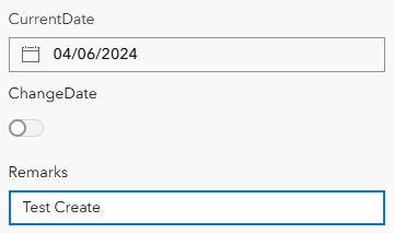

As an Arcade novice, I am wondering if someone would provide the exact syntax for the following scenario:
Feature layer has three fields: CurrentDate, ChangeDate (Yes/No Domain as above), and Remarks. For an existing feature, I want to update only the Remarks field and leave the CurrentDate to the value that was set on initial creation (during insert).
What would the calculated expression be in this case. I would still want to use the Yes/No toggle for the Editable expression on insert.
Thanks
ShareUser
@WetherbeeDorshow
So you would have a calculated expression against the CurrentDate field (unless you only want manual entry to permit backdating in the first instance. The below will return the date and time if the field is empty (feature creation). If it is not empty (editing) then it will retain the existing value:
var cd = iif(isempty($feature.CurrentDate),$feature.CurrentDate,Now())
return cd
Then use the below conditional statement for editing against the CurrentDate field (which you can create without needing to write arcade in the expression builder (though it formats it slightly differently):
$feature.ChangeDate == "Yes"
It is behaving a little unexpectedly in that when you change an edited values toggle back to "No", it reverts the CurrentDate field to todays date, but that might be fine for you (leaving the switch as "Yes").
Curious to see if anyone else has another solution. I can't seem to make it work around the issue above without the default date calculation failing to run until the toggle is switched to Yes then back to No when creating a feature. GIF below shows intended functionality plus bug at the end.

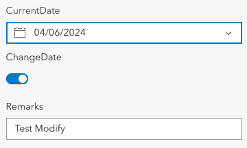

Hi @WetherbeeDorshow,
This took some playing around and picking some smart people's brains, but I think I have a solution that works and gets around the issue outlined by @LindsayRaabe_FPCWA  above.
Here's a sample web map that includes an example with the solution applied:
View Sample
You can save a copy of that web map to your Content and explore the Form and the way I configured the expressions.
Here's the Calculated expression for the Current Date field:
The logic for setting the Current Date as editable based on the Change Date field value is the same as described in the current blog post.
Hi @Kevin_MacLeod. Yes, it is the case that templates can only be modified in Field Maps Designer for hosted feature services. After you updated the default value at the SDE level have you tried then removing and re-adding the service from the map?

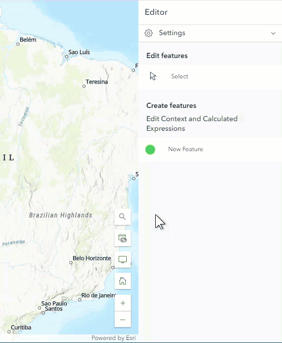

@AlixVezina Great little video. I've learnt something new from it - how to use the $editContext vs $originalFeature thingo's.

The expression itself works — but only after I first save the new record and then go back to toggle the Override field.
If I try to toggle Override to Yes before saving, the On_Street value gets set to null.
In Alix’s example with the CurrentDate field, the override behavior works instantly without needing to save first. In my case, it’s not consistent, because it works on Alix example but not mine even though I am doing the same thing as her example. It makes me wonder whether I’m missing a step or if this is a known limitation when using expressions that reference another layer (FeatureSetByName) inside Map Viewer.
