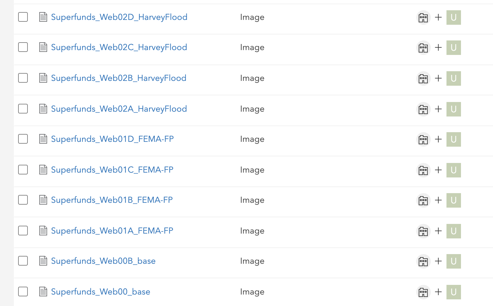

I thought it might be because I uploaded the images directly to the storymap rather than to my Content first.  So I uploaded the images to my Content and they're not even showing as available media within the storymap configuration interface.  What am I missing here?
These are all in my Content and shared to my organization and a group:

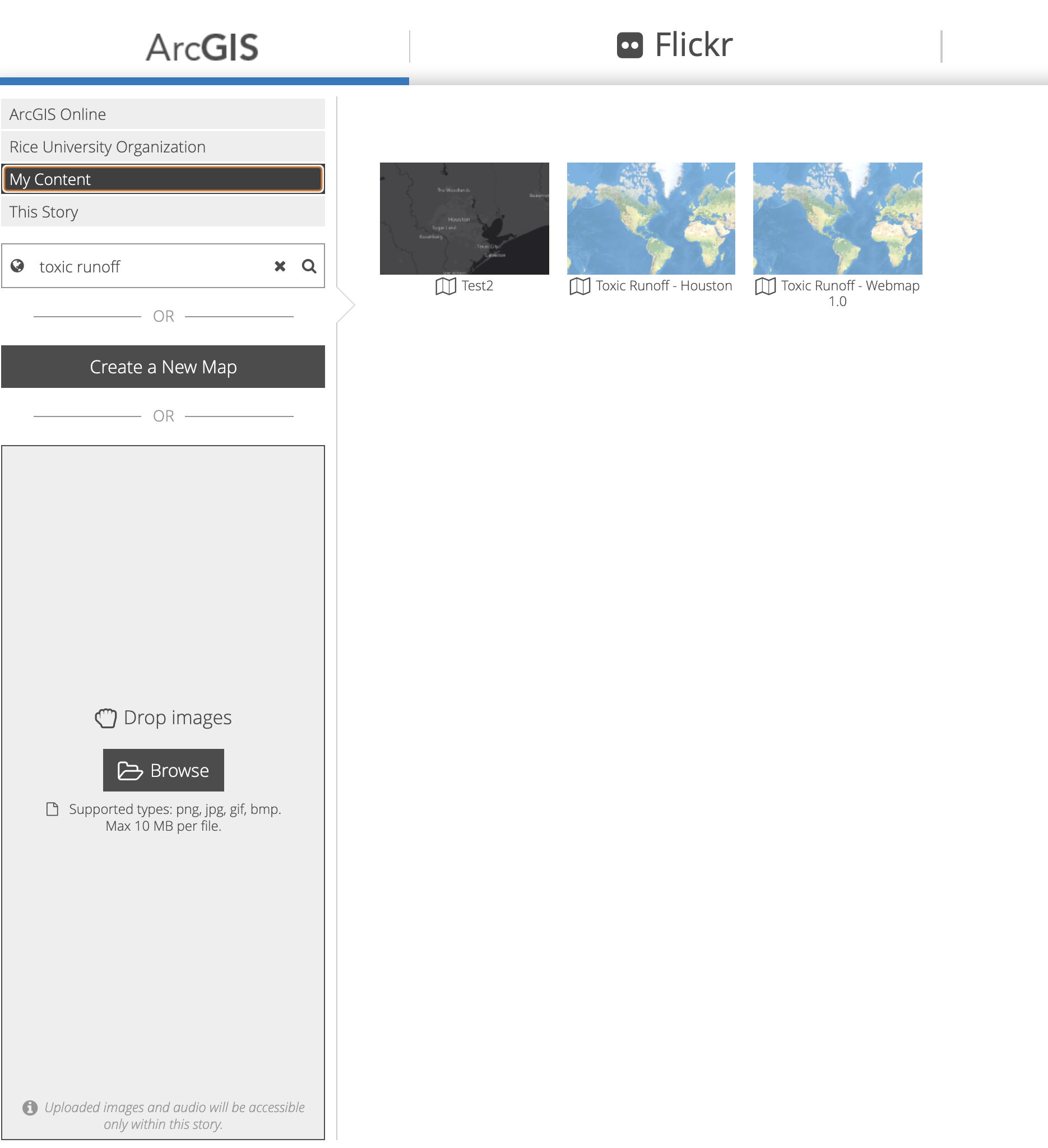

But none show up in the cascade configuration interface?!

@MikeW_1  -- I'm sorry you are having an issue with your story. The recommended way to add images to a classic Cascade story is to upload them in the builder. Adding images to you ArcGIS content does not automatically make them available in the story builder.
