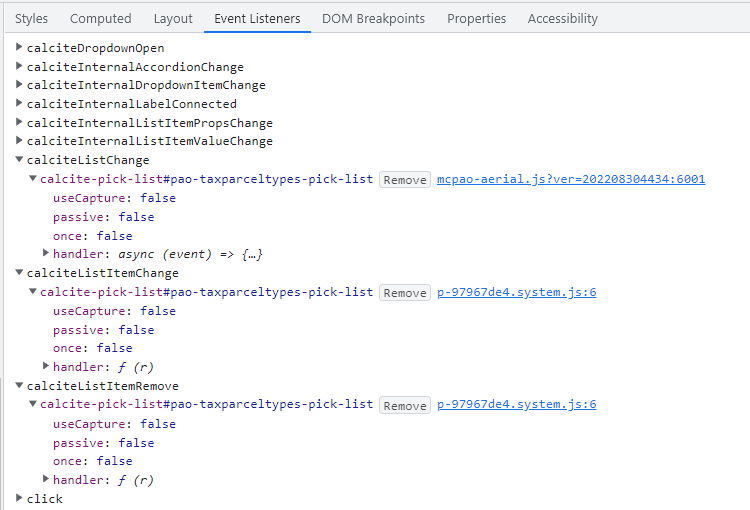

I have a calcite-pick-list with a calciteListChange event listener. This is working fine except when I reset the calcite-pick-list-item(s) to have them all selected. I do not want the change event to fire. I tried adding a removeEventListener before selecting the items and then returning the calciteListChange event listener but this didn't help.

The attached Event Listeners

It would probably be easier to add a conditional in the event listener's callback function (handleTaxParcelTypesChange), rather than dynamically adding/removing the listener. Here is an example:
https://codepen.io/benesri/pen/bGvXZgz?editors=0011

GregoryBologna
Thanks for the example. Works perfect.
