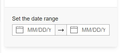

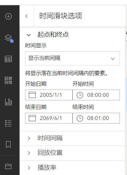

This component is in "calcite-panel" and its scale attribute is set "s" . While it is still not narrow as expected. As the code pen.  It works fine in arcgis online web viewer as the screenshot below. This panel is in the "map settings" button clicked. The map contains a feature service with time-slider in my local server.

       The "MM/DD/YYYY" placement  in the component is not displayed completely as the screenshot below.
