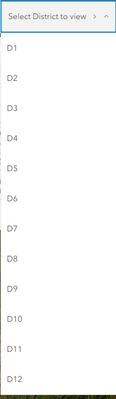

Just click for example, the East and then SouthEast. You expect that after you click the SouthEast you will close the menu, instead it will stay open. Also, is there a way to reduce the spacing between  the items. See my screenshot, it take a lot of space. What is the css for this. Thank you.

Regarding the spacing between menu items, this is not currently customizable, and there are no immediate plans to introduce this functionality. However, I will bring this up with the team for further discussion to see if we can consider it for a future update.

Great. Thank you. Nice way to address the issue, temporarily, correct? So, there is no way through the use of css to adjust the spacing between the menu items? I have 12 items and it occupies 70% of the screen! Ridiculous.
