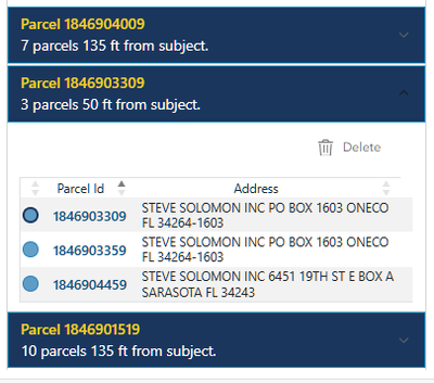

I am adding style to an accordion item, but when the calcite-accordion-item is first added to the calcite-accordion container, the shadowRoot  ".header" is not available yet. What is another way to add style to this?
Accordion item not styled until shadowRoot is ready.
Accordion item styled.
Only works when shadowRoot is built.

GregoryBologna
Take a look at styleAccordionItem() and changeHeadingStyle()
You can see it in action here. Click 2nd widget from bottom shown in screenshot.
https://www.manateepao.gov/parcel/?parid=1014100000
