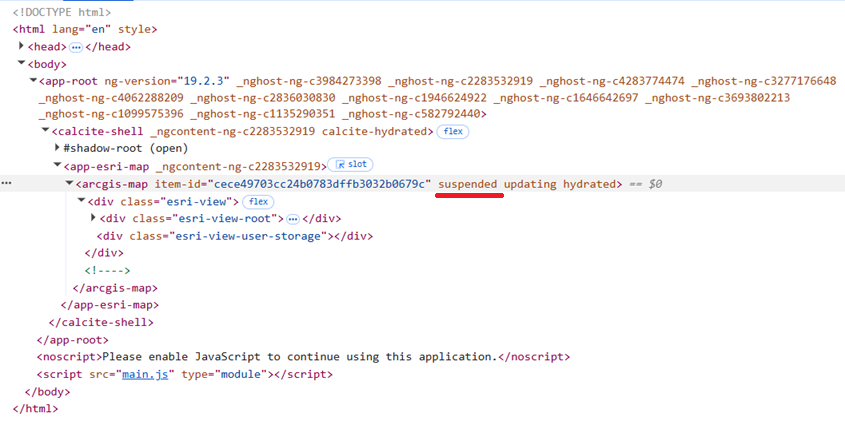

The map doesn't show in browser.
 I inspect the document:
The map component <arcgis-map> is suspended.
ForrestLin
Issue is resolved:
`<app-esri-map>` element needs a height and width in css:
app-esri-map {
  padding: 0;
  margin: 0;
  height: 100%;
  width: 100%;
