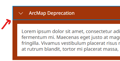

I'm trying to use the accordion component in an ArcGIS Hub page and have figured out how to change the colors for almost everything except this blue border that appears when you expand the component. I tried using --calcite-accordion-border-color per Accordion | Calcite Design System | Esri Developer , but that only adds a very thin border to the bottom of the accordion. Any ideas? It's obviously not an urgent need but the perfectionist in me wants it to match our branding.

Hi @AaronKoelker it looks like the Accordion Item is in focus, so the focus ring color is displaying on the component. You can customize, or modify the variable --calcite-color-focus, and in the upcoming 3.1 release will also default to the --calcite-color-brand CSS variable.
For instance, and also in this Codepen:
#a-custom-accordion-item {
  --calcite-accordion-item-background-color: #a2350a;
  --calcite-accordion-item-heading-text-color: #fff;
  --calcite-accordion-item-text-color: #fff;
  --calcite-accordion-border-color: #d07954;
  --calcite-color-focus: #fff;

AaronKoelker
@KittyHurley  Aha! I didn't know the "focus" was even a thing—am still learning. Thank you so much for the quick answer, that worked perfectly.
