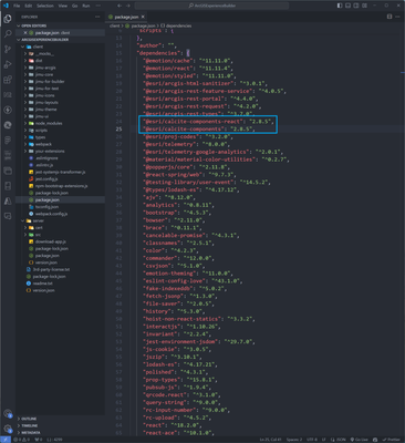

ForrestLin
Experience Builder has dependencies:
@esri/calcite-components
@esri/calcite-components-react
